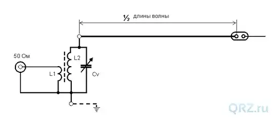

Modern Fuchs antenna looks like this:
The L1,L2 is a transformer, typically 64:1 or 49:1. It is required because the end fed half wave wire has an impedance about 2500..3200 Ohm, assuming a counterpoise wire is about 0.05 lambda. OK, this is clear.
Also the L2,Cv circuit has to resonate on the frequency of interest (e.g. 7.1 Mhz for 40m band). This is the part I don't quite understand. Why using only a transformer is not enough to convert 2500..3200 Ohm to 50 Ohm of the feed line and feed the antenna as a regular dipole? Why we also need a capacitor to form a resonant circuit? Or, in other words, what happens if we remove Cv?

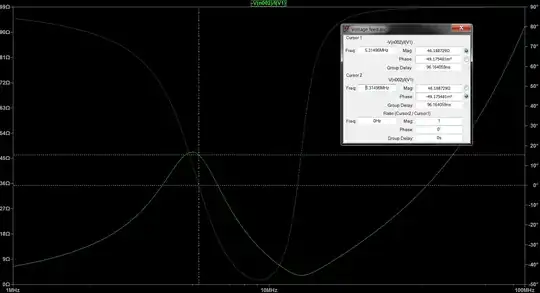

This is the impedance presented to the generator vs. frequency:
Judicious selection of components produces the desired match at the operating frequency. Air-spaced and vacuum-variable capacitors are often used to accommodate: the difficulty of knowing the antenna impedance at a particular frequency; the narrow operating bandwidth; the high voltages that come with high-impedance levels. This method, commonly referred to as "voltage feed," is often used with end-fed antennas such as half-squares, etc.

L2 and Cv builds an resonant circuit (or tuned circuit) to the desired frequency.
If you remove the C or change it to a small fixed value and hold on this transformer ratio, you change the antenna "type" to an EFHW.
Generally a transformer has an high bandwidth than an resonant circuit. It has a very small bandwidth.
This means a Fuchs antenna does some filtering on the used wire and a EFHW not so much. So the EFHW antenna should give more noise from differed frequencys to the output than a Fuchs antenna. But it needs not to tuned across the resonant ham bands.
In any case you will not feed the antenna like a dipole. The radiation diagram looks close like it but dipole means always an center-fed antenna. This antenna types are all end-fed.
