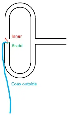

Can I feed a folded dipole constructed of hollow tubing by threading coax through the element to create both an impedance transformation and balun? I have fed coax through the tubing of the dipole from a point opposite the feed point and soldered directly to the open ends of the dipole from inside the tubing. SWR seems ok with 50 ohm cable but a I being fooled into thinking all is ok? A bit hard to explain, the coax is inside the element for 1/2 wavelength.
1Thanks for joining us. Please report the observed SWR when coax is connected directly to the antenna terminals. – Brian K1LI Jun 15 '19 at 20:49
1When I connect the coax to the folded dipole terminals directly I get an SWR of around 8:1 . When I run the coax inside the tubing of the element for 1/2 wave before connection I get 1.2:1. I am wondering if this is actually working as it should because it seems "Too" good! I mean I can get a great SWR by just sticking the coax in a bucket of water but it doesn't radiate very well! – R Johnson Jun 16 '19 at 08:25

1) This is the case I believe you are describing:
The coax is hidden entirely inside the pipe, so it has the minimum effect on the patterns, and no balun is required to feed the balanced antenna from the unbalanced input. The coax should see the full 200-300 ohm impedance of the folded dipole, so a bad match without further work.

3) I recommend something like this:
With the coax run through the pipe, the required balun action is taken care of.
Some impedance transformation is required. In this drawing I've shown a piece of 100 Ohm cable, 1/4 wave long, when I built some of these I used a small PCB across the feed gap, which makes the connections more robust and takes care of the 100 Ohm line. You could also use an actual 4:1 Unun transformer, or even an LC network, though that will be quite narrow band and spoil the dipole.

1Yes your diagrams are exactly what I have done. I think the 1/4 wave matching section is what I require! Thanks for that ! – R Johnson Jun 18 '19 at 00:21
I wonder if I can fabricate the matching section from commercially available coax There is some 92 ohm cable around or will just length adjustment of somthing like 75 ohm cable be an option? – R Johnson Jun 18 '19 at 00:23
@rjohnson Yes! You can use 3/4 wavelengths, it will reduce the matching bandwidth slightly, not a problem for hams. 92 Ohm coax should work. Keep the velocity factor in mind - it will be only 1/2 wavelength physical lendth which will only just make it around the dipole. This creative idea makes you an Honorary Antenna Engineer, keep it up. – tomnexus Jun 18 '19 at 04:51

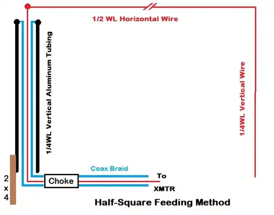

Would you, please, explain the function of the 17ft aluminum tubing? – Brian K1LI Jun 15 '19 at 20:48
@Brian The 17 ft aluminum tubing is one of the vertical radiators for a 20m half-square. The coax is normally routed at right angles to the other conductors and connected at the top of the radiator. My coax goes up through the radiator and connects at the top while using the radiator as a support. This configuration is somewhat similar to the question being asked. – Cecil - W5DXP Jun 15 '19 at 21:38
Thanks - I see it now. Feeding the half-square at one of the corners gives a good match to 50$\Omega$ coax. – Brian K1LI Jun 15 '19 at 23:52
