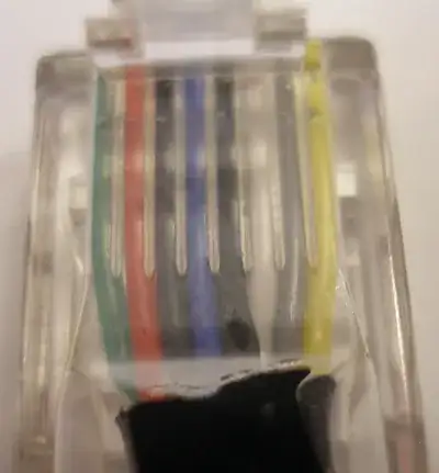

After cutting the cable, I discovered something completely unexpected. Although it looks as if the RJ-45 plug has 8 insulated connectors:
top view of jack with 8 wires connected

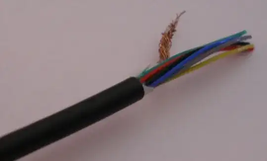

the cable itself has only 7 (plus a shield):
end of cable with 7 wires + shield

    first of all, make double sure you've not accidentally ripped one cable out when cutting the cable; the eight one has to appear from "somewhere". Other than that, in your top photo it looks like there's two black cables – it's not unreasonable to assume they carry the same ground. – Marcus Müller May 07 '19 at 11:34
  • Is the top photo the original plug? It looks like there are two black wires. Perhaps one of them was black sleeving covering the shield. – Mike Waters May 07 '19 at 15:20
    I can verify that I didn't rip a cable out - I cut it with diagonal cutters. @MikeWaters suggestion of a black sleeve is intriguing, I'll check continuity between the shield and the connectors on the other side of the cable. – user3486184 May 08 '19 at 20:53

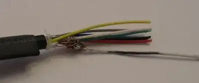

Step 3. Trim about 1 inch (25 mm) of the remaining jacket. Carefully unweave the braid from the clock line (on mine it was the white wire), separate the copper braid from the cloth braid, and wind the copper braid into a wire. (Although my original RJ-45 jack had two black wires, they were not electrically connected.)
Closeup of cable, with shield twisted to form a wire.

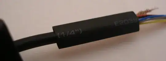

Step 4. Very important: now is the time to pull the boot down as far as it will go, and put the heat shrink on the wire. I ended up wishing I'd made my heat shrink longer - it fits, but exposes the same weak spot the cable originally had. If I'd added an extra inch (25 mm) or so, I'd have a stronger cable, I think. You can slide the boot partway down the curly part of the cord if you need more room.
Closeup of heatshrink placed on the cable, but not yet shrunk
Step 5. Sacrifice the network cable and take out about 3 inches (75 mm) of one wire. (I used the white/brown, so I wouldn't confuse it with the other wires.) Strip the wire back on one end. Carefully tack-solder that end of it to the base of the copper braid. I tried not to solder the whole braid so I would have some flexibility.
Image of brown/white wire from network cable tack-soldered to base of braid

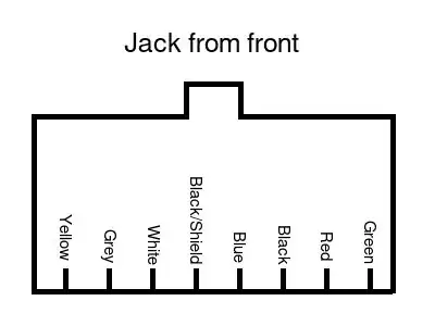

Step 6. Feed the individual wires through the EZ-RJ45 jack. Order here is important. On my jack, it was:
  • yellow
  • grey
  • white
  • originally black connected to the shield, now white and brown
  • blue
  • black
  • red
  • green
Leave the wires long to give you plenty of room to work.
Here's a face-on diagram of the jack:
View of jack from front of jack. Yellow is on the left, then grey, white, black/shield, blue, black, red, then green on the right.

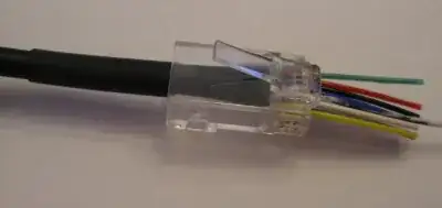

Step 7. Adjust the EZ-RJ45 jack first so it's in position, then put the heat shrink where it needs to be. Slide the EZ-RJ45 jack so it no longer covers the heat shrink. Heat the heat shrink so it conforms to the wire. Slide the EZ-RJ45 jack back down over the heat shrink.
Heat shrink shrunk around cable, with EZ-RJ45 in position, not yet crimped

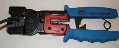

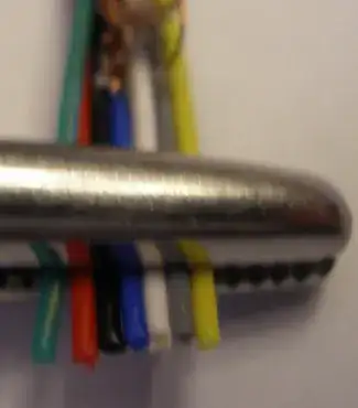

Step 8. Crimp the EZ-RJ45. I didn't have the official EZ-RJ45 crimper, so I used my RJ-45 crimper and then trimmed the wires off with a utility knife.
Picture of the crimper in action

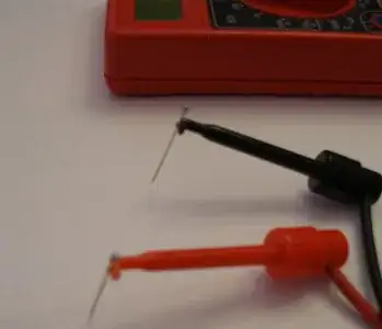

Step 9. Check all the wires for continuity with the RJ-45 connector on the other end. I used an ohmmeter with a couple of sewing pins held by mini-grabber test leads as probes.
Picture of probes (mini-grabbers grabbing sewing pins)

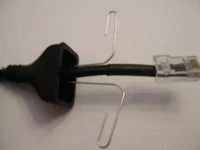

Step 10. You're almost done! (If the boot weren't so tight, you'd be done. But it's tight, and unless you're careful, it will push the heat shrink out of shape as you slide it up.) Deform two paperclips and slide them between the wire and the boot, and use those to wedge the boot around the heatshrink.
Paperclips unfolded and placed between wire and boot

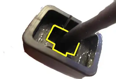

Note as you slide the boot up that it has an orientation. Make sure the cut in the molded boot matches the tab in the EZ-RJ45 jack.
Closeup of molded boot with cutout for RJ-45 tab
