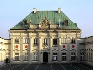

Copper is a better conductor than gold, but copper will form a layer of oxide or other tarnish through normal exposure to the elements that will eventually increase the contact resistance of two mating copper contacts, rendering the connection faulty. See for example, architectural copper roofs:
copper roof on Warsaw palace
Where this corrosion isn't desired in architectural applications, a protective coating is applied. This isn't feasible in electronic applications since such coatings are generally non-conductive.
