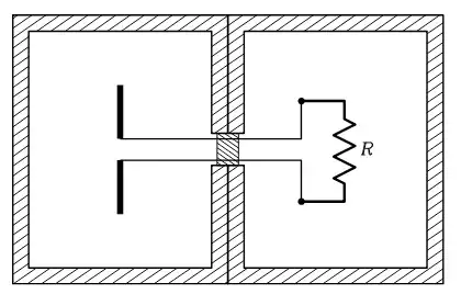

For some context, the relevant part of the cited source:

The description follows after a description about thermodynamic equilibrium and this illustration:
A cavity in thermodynamic equilibrium at temperature $T$ containing a resistor $R$ is coupled to an antenna, also at temperature $T$, through a filter passing frequencies in the range $\nu$ to $\nu+d \nu$.
The discussion involves the thermodynamic equilibrium between the resistor and the antenna. This "average collecting area" is describing what should be fairly intuitive: this equilibrium holds regardless of what kind of antenna is put in the left cavity.
In other words, the average collecting area has something to do with how the antenna responds, on average, over all directions. It must be the same for all lossless antennas because anything else would violate conservation of energy.
