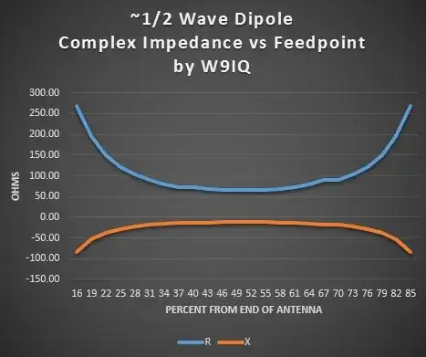

Start with a standard 1/2 wave, center fed dipole. Close to earth, the impedance will be ~50 ohms with very little reactance. Now start moving the feedpoint towards either end of the antenna and the impedance begins to rise - both the resistive and reactive parts. If you continue towards the very end of the antenna, the resistive and reactive part of the impedance become very high - greater than several thousand ohms each.
The problem comes in when we finally get to the end of the wire - there are not two places to connect the feedline. But because we can see the impedance rising as we approach the end of the antenna, we can theorize that it is even higher at the very end of the antenna. This can be difficult to match to 50 ohm coax. Since the impedance is very high, for a given amount of applied power, the voltage is also very high in this area:
$$\text{Voltage}=\sqrt{PR} \tag 1$$
So care must be taken. For example a 100 watt transmitter could develop more than 700 volts across a 5,000 ohm load when there would be only 70 volts present across a 50 ohm load.
But a much more important consideration is if only one side of the feedline is connected to the end of the wire, how can the antenna radiate if their is no return path? The answer is that typically the exterior of the shield of the coax cable is acting as part of the antenna. This means that the antenna is not a 1/2 wavelength of wire but rather something longer. How long is highly installation dependent but we can say for certain it is longer than 1/2 wavelength. So all of the concern about a 1/2 wavelength antenna is a bit misplaced.
Why So Many Impedances?
The reason a single piece of wire has different impedances along its length is due to reflections of RF energy that gives rise to standing waves. As RF current travels along the wire, it eventually reaches the end of the wire. Since the end is nearly an open circuit, the wave is reflected back toward whence it came. But when it starts its return trip, the phase of the wave is different from the original wave. So the peaks and troughs of the two waves do not line up to each other.
While there are now two waves traveling in opposite directions on the wire, when we take typical voltage or current measurements at any point on the wire, we are observing only the combined voltage or current of all of the traveling waves. Since impedance is simply voltage divided by current, the impedance therefore varies in accordance with the combination of the repective waves.
