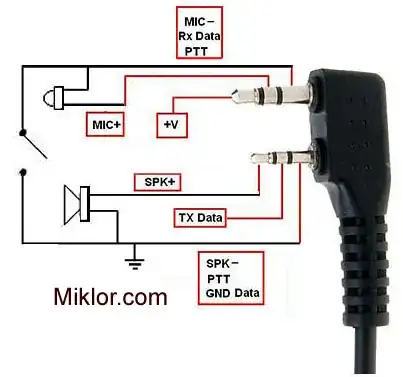

An external PTT switch is easily added. Here is a nice diagram from the miklor.com site.
You can see the switch to the far left of the circuit. It is wired to the outer most "ring" of each plug. Closing (pressing or toggling) that switch will cause the radio to transmit.

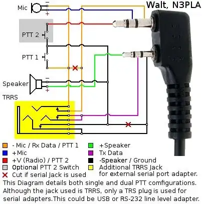

Here is the schematic from the same site showing the dual PTT and the optional data connection:
