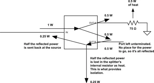

For example, say 1 W enters the input port. One output is connected to a TV, which we assume is properly terminated internally. The other port is left open. (In practice the power is orders of magnitude less: I want to keep the numbers simple.)
schematic
simulate this circuit – Schematic created using CircuitLab
What happens:
  1. 1 W enters the input.
  2. The splitter divides that power evenly between the outputs. So 0.5 W comes out of each output.
  3. On port A, that power is converted to heat in the TV and we don't need to worry about it anymore.
  4. On port B, there's nowhere for the power to go so it's reflected. Now it's an input on "output B". Although it's called an "output", because the splitter is a reciprocal device, it works an an input, too.
  5. Half of the reflected power is lost as heat in the splitter.
  6. The other half is sent out the "input" port.
  7. Depends on what's attached to the input port!
If the input port is also 75 ohms, the reflected power is absorbed there, and we don't ever see it again. This reflected power means the source does not "see" 75 ohms, however that's unlikely to be an issue in practice for a TV system.
But if the input port isn't 75 ohms, the reflected power gets re-reflected and is sent another time into the input port. Now you have the opportunity for ghosting.
