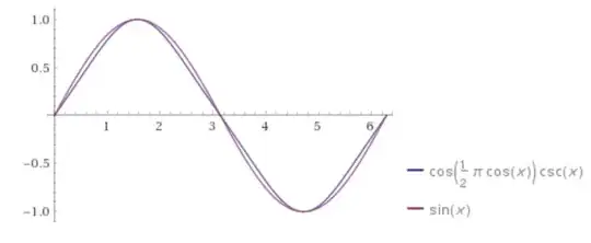

The corresponding formula for a half-wave dipole is:
$$ E(\theta, \phi) \propto { \cos\left( \pi \cos \theta \over 2 \right) \over r \sin\theta }$$
As you can see graphically, the half-wave dipole is just a little more "pointed":
Thus, if the two antennas have equal efficiency, the half-wave dipole will have just a little more gain.
Why so? No one actually builds infinitesimal dipoles: theoretically their gain is about the same but in practice their efficiency is extremely low. However, they are mathematically simple, and a very good approximation of real antennas can be made by modeling them as a collection of infinitesimal dipoles. The caveat is the infinitesimal dipole model assumes uniform current throughout, so we must divide the antenna into pieces small enough that each individual piece has mostly uniform current.
Thinking of a half-wave dipole in this way, you can now consider it sort of a colinear array of infinitesimal dipoles. It isn't physically large enough to yield a lot of gain, but it does yield just a little: 0.39 dB. We see that in the graph above.
