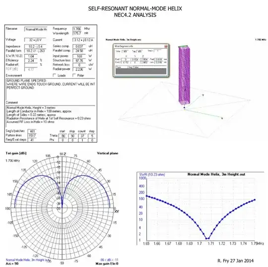

The text and graphic below were added 21 Sept 2018
There may be some who believe that a loading coil has an electrical length and radiation resistance related to the linear length of the conductor used to construct that coil. However as stated by J. Kraus in Antennas, 3rd Edition, p. 296 and shown by NEC4.2, such coils have very nearly the same electrical length and radiation resistance as a single, linear conductor having the same end-end, overall length (aperture) as the coil.
Note in the NEC study below that the coil contains a conductor of about 100 meters in length, which is greater than one-half wavelength at that operating frequency.
If that 100-meter, ~1/2-wavelength conductor was straight (linear), its radiation resistance at that frequency would be (approx) 100 Ω. Yet as shown in the Comment block in that graphic, when that 100m conductor is wound in the form a self-resonant coil, its radiation resistance is only 0.23 Ω. (Also note that the gain of the antenna system modeled in this NEC study is at least 15 dB below what it would be if using a ~1/2-wavelength, base-driven, linear monopole.)
Therefore, such loading coils are very ineffective in adding "missing degrees" to an electrically short, linear radiator.
