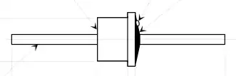

What they mean by "coaxial capacitor" might be described by more people as a feed-through capacitor. For an example, see Tusonix 4300-002LF at Mouser. The datasheet contains these images, which are pretty informative:
drawing of capacitor schematic
Thus, the two leads are effectively a wire, ideally having zero impedance between them. However, this conductor also has some capacitance to the case, which is usually connected to ground. This particular part is designed to be dropped in a hole the size of the case, then soldered in place. Another design has a tab on the case for screw mounting.
The advantage of this arrangement is that it's possible to use as a filter on some wire with high $\mathrm{d}v/\mathrm{d}t$ without creating a stub which could also act as an EMI radiator. It's also possible to preserve the continuity of a shield or enclosure, and get a really good connection to it. With an ordinary capacitor, the ground connection would go through a lead, which would have more inductance and resistance, reducing the filter effectiveness.

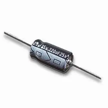

There's a similar looking, but different thing: axial-leaded capacitors. These are frequently electrolytic. Example:
There's nothing special about this capacitor. Sometimes this arrangement of leads just fits better.

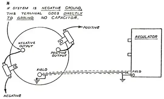

While writing the question I found a picture that clarifies the “in line” part on this web page I found in a search, Radio Frequency Interference: A small vessel guide:
To cure alternator noise, which is pulses radiate from the output lead, it is necessary to filter the output lead as close as possible to the alternator. The most effective filter is a 0.5 microfarad coaxial capacitor. A coaxial capacitor is one which passes current through its center with the capacitor completely surrounding the current carrying lead. As the alternator current flows through the capacitor, it should be rated to handle the alternator’s maximum output current.
So, a coaxial capacitor in this context is in fact a three-terminal device of a sort, and this explains why it could be described as being “in line” with the alternator leads.
This doesn't explain why a coaxial capacitor is specifically good for this application, though.
