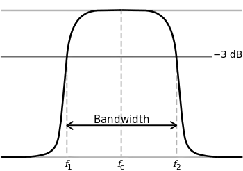

When considering the Q of a tuned circuit, Q = frequency / bandwidth where the frequency is the resonant frequency of the tank and the bandwidth is the frequency difference between the 3 dB points. As shown (Wikipedia):
Curve of a tuned circuit
