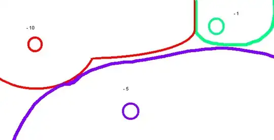

I have a number of different points, each point has a -z value. I need to create some sort of raster or a series of polygons which buffers these points.. but i have a few complicated rules!
  1. If the adjacent points are of the same z value then the buffer must merge into one polygon.
  2. if the adjacent point is a different z value - then the buffers must be weighted in accordance to the depth of the z values, i.e. if one z-value is -10, and the other is -5, then the buffer of the -10 point will take up 75% of the distance between the 2 points. But because there are many points, and they are all related, this buffering will be different on different sides of the point, see diagram!enter image description here
  3. The idea of the weighted voronoi diagram has been suggested to me and that would be perfect if it weren't for all of the points being related to all of the points around its!
  4. I know how i would do it on paper - i would divide the space between all points by 10, and then based on the difference between the two points choose where the buffer would start (if there is no difference between the points then the buffer starts in the middle).
  5. Although i cannot work out the formula for determining where the buffer starts.. i know it must be derived from the DIFFERENCE between the two points - but i do not have the mathmatical capacity to work out how i would use this to work out the distance!

    What is the relationship between the lines and the points in this drawing? What do the colors mean? How would this be represented as a raster? Exactly how is the raster to be "based" on the point values? What exactly are the "some rules" you have in mind? It would help to understand what the original data mean and what you intend the resulting raster to convey about them: are you interpolating, finding a density, spreading, clustering, or doing something else? – whuber May 02 '11 at 14:22
  • Thanks for the edit: it clarifies the nature of the problem. But it will be next to impossible to propose a solution until you can describe the buffering rules precisely. – whuber May 04 '11 at 21:27
  • The problem, as you stated it on the ESRI forums, looks fairly simple (although its solution might not be!) But exactly how do you determine that the buffer weight for z=-24 compared to z=-20 must be 75% but for z=-24 compared to z=-23 it is only 60%? What is the formula? And when you say "take up 60% of the space" are you referring to the areas of the buffers or the distances between the boundaries and the points or to something else? – whuber May 08 '11 at 14:28
  • I mean the distance between the 2 points.. so if they are 10m away from each other and one is -20 and the other is -25 then the -25 buffer will start 2.5m from the -20 point! – Alice May 09 '11 at 06:36
    The question is, how do you determine the value of 75% from the numbers -20 and -25? What is the formula? If you can't provide that then nobody can help you. – whuber May 09 '11 at 14:58

If I understand your question, an algorithm that may work (i.e. it does in my head, but I've not tried it), and would require some scripting goes something like this:
  1. Generate the Voronoi/Theissen polygons of your points.
  2. Take the inverse of those polygons, that is there will now be edges connected to your original points.
  3. For each edge e connected to point p, calculate the relative distance along e such that it is a proportion of the end points' weights. I.e. w / (w' + w), where w is the weight of p and w' is the weight of p', the other end of e. (If you need the inverse, that is -10 is "heavier" than -2, just subtract this value from 1).
  4. Scale e in proportion to the value obtained in 3), and its new end point will mark the weighted boundary between the two points. Associate this boundary point with p. Do this for every edge, remembering to duplicate the new boundary point for p' so you won't need to calculate it a second time.
  5. You will now have a ring of points associated with each of your original points. Join these up into polygons which have a weight attribute that is the same as the point that they enclose.
  6. Merge all adjacent polygons with the same weight attribute.
You may need to check that each point p has more than two edges radiating from it to avoid degenerate polygons which may happen with corner cases, but I think that should work.

  • this does sound like a good method! ..Do you know which bits i would need to script? I've only ever done some very, very basic python scripting before! – Alice Jul 22 '11 at 06:13
  • Unfortunately I'm not much of an arcmap expert, but I expect steps 1, 2, and 6 could be done in the GUI, but the rest would probably need to be scripted. Any ESRI experts out there willing to flesh out the bones? – MerseyViking Jul 22 '11 at 09:14
    The inverse of a voronoi diagram is a delaunay triangulation. – Alex Leith Aug 09 '11 at 06:37

  • @Paul I'm still trying to understand your approach. It is evident that the boundaries of these buffers will usually have variable distances to the original points. What tool in ArcInfo does that and how does it control the buffer distance? – whuber May 08 '11 at 14:58
    @whuber : I don't know of any tool that gives a variable distance based on adjacent point and a percentage of the white space between those points. However if these buffering rules (that we don't have) show that each unique z-val has a linear unit associated with it, then a "linear_unit" field could easily be added to the data source and the buffer distance could be based on this new field. I agree with your earlier comment that until we actually know the buffering rules, we won't be able to answer this question. – Paul May 08 '11 at 15:07
  • @Paul You're right: we need more information. In the meantime, with each successive edit this question sounds more and more like a request for a weighted Voronoi diagram. Although ArcGIS does not have such a tool, such things are straightforward to create with raster calculations. – whuber May 08 '11 at 15:14
  • I dont actually have any rules as of yet - today i will work out a definate formula and then get back to you!! Thank you so much for your help! – Alice May 09 '11 at 06:29
  • I have just been reading about the voronoi diagram and it does sound like what i am trying to do! And i really like the sound of it being "straight forward" to create!! – Alice May 09 '11 at 06:36
  • Sorry it has taken so long to reply - i was hoping the problem would just go away but it hasnt! The problem with a formula is that because all points will be relative to each other, there will never be one definitive linear_unit which we can set. e.g. if a -20 and a -20 were next to each other - then the buffer would start equidistance between them, but if -20 and -10 points were next to each other, the -20 buffer would start 75% between it and the -10 point!! – Alice Jul 12 '11 at 13:10
  • What i have been thinking is that i would build a formula based on the DIFFERENCE between the 2 numbers, so if there was a difference of 0 (in the case of -20 and -20), then the buffers would start between the two points, but if there was a difference of 1 then the buffer would start 60% between the two points.. i am just wondering how to execute this! – Alice Jul 12 '11 at 13:28
