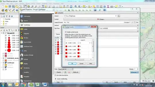

Click on advanced then symbol levels then number the symbols by choosing which symbols you want at the front
