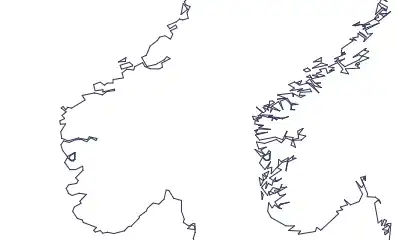

If you need to preserve the topology you can also have a look to Mapshaper. This is a javascript command line tool, but also a web interface and can be accessed in R through the rmapshaper package.
Image from here: 5% simplification; left: Visvalingam simplification (default in mapshaper), right: Douglas-Peucker simplification. Works extremely fast and is as easy as this line of code:
mapshaper input.shp -simplify 10% -o out.shp
