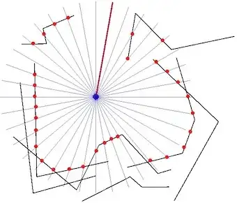

From a known Point, I require to establish the nearest surrounding "visible perimeter" against a table of MultiLineStrings, as shown on the diagram.
I've searched this site with a number of terms (e.g. minimum edge, minimum perimeter, nearest neighbour, clip, containing polygon, visibility, snap, cut nodes, ray-trace, flood fill, inner boundary, routing, concave hull) but cannot find any previous question which seems to match this scenario.
Diagram
  • The green circle is the known Point.
  • The black lines are the known MultiLineStrings.
  • The grey lines are an indication of a radial sweep from the known Point.
  • The red points are the nearest intersection of the radial sweep and the MultiLineStrings.

  • Undertake a radial sweep by constructing a series of lines from the known Point (at, say, 1 degree increments).
  • Establish the nearest intersection point of each radial sweep line with the MultiLineStrings.
  • When one of the radial sweep lines doesn't intersect with any of the MultiLineStrings, this would indicate a gap in the perimeter which would be accommodated in the perimeter MultiLineString construction.
Summary
Whilst this technique will find the nearest intersections, it won't necessarily find all the closest perimeter node points, dependent on the resolution of the radial sweep. Can anyone recommend an alternative method to establish all the perimeter points or supplement the radial sweep technique with some form of buffering, sectoring or offsetting?

I have reproduced your example with shapefiles.
You can use Shapely and Fiona to solve your problem.
1) Your problem (with a shapely Point):
2) starting with an arbitrary line (with an adequate length):

3) using shapely.affinity.rotate to create the radii (rotating the line from the point, look also the Mike Toews's answer at Python, shapely library: is it possible to do an affine operation on shape polygon?):
from shapely import affinity
# Rotate i degrees CCW from origin at point (step 10°)
radii= [affinity.rotate(line, i, (point.x,point.y)) for i in range(0,360,10)]
4) now, using shapely:cascaded_union (or shapely:unary_union) to get a MultiLineString:
from shapely.ops import cascaded_union
mergedradii = cascaded_union(radii)
print mergedradii.type
MultiLineString

6) the intersection between the two multigeometries is computed and the result is saved to a shapefile:
 points =  mergedlines.intersection(mergedradii)
 print points.type
 MultiPoint
 from shapely.geometry import mapping
 schema = {'geometry': 'MultiPoint','properties': {'test': 'int'}}
 with fiona.open('intersect.shp','w','ESRI Shapefile', schema) as e:
      e.write({'geometry':mapping(points), 'properties':{'test':1}})
Result:
7) but, problem, if you use a a longer radius, the result is different:
8) And if you want to get your result, you need to select only the point with the shortest distance from the original point on a radius:
points_ok = []
for line in mergeradii:
   if line.intersects(mergedlines):
       if line.intersection(mergedlines).type == "MultiPoint":
          # multiple points: select the point with the minimum distance
          a = {}
          for pt in line.intersection(merged):
              a[point.distance(pt)] = pt
          points_ok.append(a[min(a.keys())])
       if line.intersection(mergedlines).type == "Point":
          # ok, only one intersection
          points_ok.append(line.intersection(mergedlines))
solution = cascaded_union(points_ok)
with fiona.open('intersect3.shp','w','ESRI Shapefile', schema) as e:
     e.write({'geometry':mapping(solution), 'properties':{'test':1}})
Final result:
I hope that is what you want.
