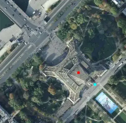

The reason is simple. Most rasters are takes from an angle, and provide an oblique view. Hence tall objects will appear to lean in an direction pointing outwards from the Focal Axis of the sensor. For example look at the following Google Maps Image of the Eiffel Tower. The Red point is approximately where the center should be, but you see the top of the tower at the Cyan Point. (This is just illustrative. Google Map's Satellite view is processed to removed these kinds of artifacts, but many still remain)
