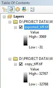

the Fill (Spatial Analyst) tool gives a wrong output for copy tiff raster. And of course from my arcpy code also. And that was the reason behind posting this question. But suddenly I noticed that, the exported tiff raster gives correct output for Fill (Spatial Analyst) tool.
The value of the copy tiff raster is same as exported tiff raster but the range of highest value and lowest value is changed. And most important thing is, when I clipped from copy tiff raster, then the clipped raster also gave correct answer.
value range of two rasters
What can be the problem with this raster? Why does it behave this way? Does this problem can occur any time?

There are a number of issues which could be at play here:
  1. You probably changed your data by using 'Fill' because it is designed to change data by filling hydrological sinks. 'Copy Raster' is the correct tool for copying rasters.
  2. Clipping can change the max/min values because your resultant dataset is not the same as what you put in unless you clipped to the exact same extent as the original data, in which case ArcMap probably is calculating statistics on the output.
  3. To be sure you are seeing the correct data range in ArcMap, you should calculate statistics (if necessary killing any associated .aux file first). If statistics have not been calculated you might just be seeing the possible extents given the bit-depth and signing of the raster rather than the actual max/min. ArcMap will automatically calculate statistics on the output of many operations and that alone might be the explanation for the differences you are seeing.
  4. Careful consideration of the effects of NoData is important with rasters. If your original raster did not have NoData explicitly defined, that could skew the min value. Clipping may have removed this extraneous undefined NoData and thereby apparently "corrected" the issue. Reclassifying may have been a better option depending on your data.
  5. Are you certain that your original file really was a GeoTiff and not just a tiff containing geographic data? A GeoTiff will contain information on projections, origin and NoData values in the header. A plain tiff will not and you must treat it a little differently.
Without seeing your original data I can't how many of the above issues apply but the statistic issue is a very common 'gotcha' along with undefined NoData values.
