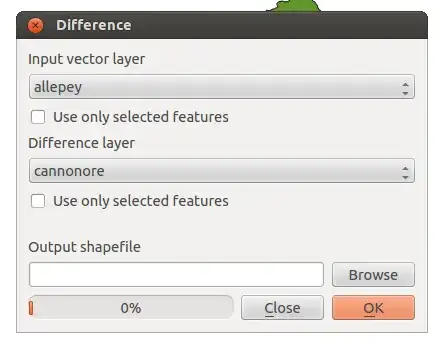

If you have QGIS. try this
  1. Load the two datasets
  2. Vector -> Geoprocessing Tools -> Difference
  3. Select Input layer, Difference layer and Output shapefile
Below is a sample screen of difference tool. enter image description here
