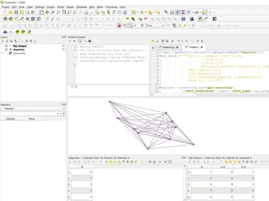

Another option is to create the lines using SQL. This query joins the point layer to itself on distance shorter than 30000 (adjust) and where the id is not the same, and creates a line between each join pair. You need a unique id column, mine is named id
select row_number() over() as id, a.id as a_id, b.id as b_id, makeline(a.geometry, b.geometry) as geometry
from thepoints as a
join thepoints as b
on st_distance(a.geometry, b.geometry)<30000
where a.id < b.id
Which you can execute using Execute SQL:
layer = QgsProject.instance().mapLayersByName("thepoints")[0]
sql_query = """select row_number() over() as id,
                        a.id as a_id,
                        b.id as b_id,
                from thepoints as a
                join thepoints as b
                where a.id < b.id"""
sqllayer = processing.run("qgis:executesql", {'INPUT_DATASOURCES':[layer],'INPUT_QUERY':sql_query,'INPUT_UID_FIELD':'', 'INPUT_GEOMETRY_FIELD':'','INPUT_GEOMETRY_TYPE':None,'INPUT_GEOMETRY_CRS':None, 'OUTPUT':'TEMPORARY_OUTPUT'})["OUTPUT"] QgsProject.instance().addMapLayer(sqllayer)

    Amazing! Thank you! – redhat Feb 05 '24 at 09:02
