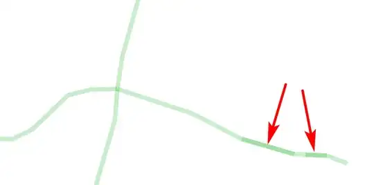

The resulting MultiLineString features of Service area (from point) and Service area (from layer) in QGIS usually contain several overlapping lines.
How can the length of the network covered by the service area be calculated?
I did not find a solution to remove all overlapping sections (see here). So I tried the following (for several overlapping service areas):

Initial service area with some segments as duplicates, visible when you set a thik line style with transparent color: where lines are darker, you have two or more overlapping lines: enter image description here
