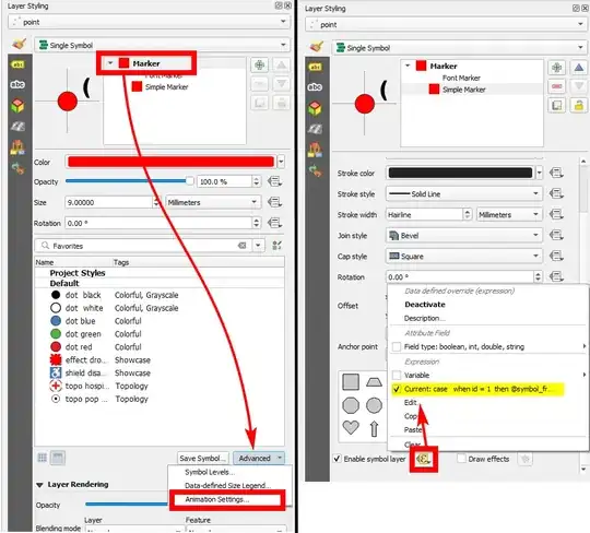

Proceed as follows (screenshots and animation for demonstration below):
  1. In the Layer Styling, select the top level of the symbol Marker, go to Advanced > Animation Settings... and set a Frame rate of 1 fps (frames per second). Make sure the Is Anmimated box is checked.
  2. Back in the the Layer Styling, select the Simple Marker entry and go down to Enable symbol layer and click data defined override (icon ɛ).
  3. To make the symbol be on/off for 5 seconds each, add the expression @symbol_frame % 10 < 5. Proceed the same way for the other layer, to be on for 4 and off for 1 second, use @symbol_frame % 5 > 0.
Or, even better, if both symbols are on the same layer, to animate the point with id=1 for 5/5 seconds, the other one for 4/1 seconds, use this expression:
case
when id = 1
then @symbol_frame % 10 < 5
else @symbol_frame % 5 > 0
end
