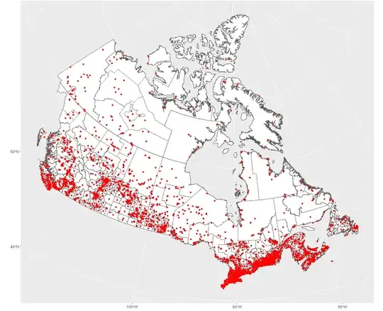

ggplot() + geom_sf(data = shapefile_1, fill = 'white') + geom_sf(data = sf_cent, color = 'red')
However, when I examine the results:
When I examine the results, I see that there are multiple centroids within each polygon.

You do only have one centroid per polygon. You just cant see all the polygons on this map.

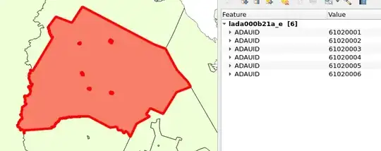

Take this bit, which looks like six centroids in a polygon.
But zoom in and you'll see its actually got five polygons inside it:
So your six points are five centroids for those holes, and one for the main polygon. These six regions have different ADAUID codes, so they are different entities in some sense, and are different rows in the spatial data.

But your stated problem, "Multiple Centroids in a Polygon?" isn't a problem! You've got one point per polygon, but more polygons than you thought you had.
If you want to somehow dissolve out these small polygons, then that's a new question. Maybe there's a field you can dissolve on, or maybe you need to keep them all in.

  • @ Spacedman: thank you so much for your answer! So just to clarify - the problem of multiple centroids in a polygon is not even occurring? if I keep zooming in, I will see that there is in fact a single centroid in each polygon? thank you so much! – stats_noob Apr 21 '23 at 14:12
  • Yes. Every red dot is one polygon, every polygon has one red dot - sometimes the polygons are so small they are hidden either by the red dot itself or by the polygon being smaller than a pixel on your screen. – Spacedman Apr 21 '23 at 15:06
