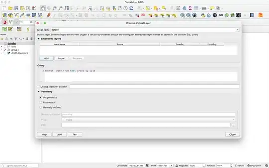

You can achieve this with an Atlas:
Create a Virtual layer wityh no geometry, that will hold the unique dates from your 'test' layer. Let's call it datelist, we will use it as an Atlas input.
In the layouts, set the Atlas to use datelist as coverage layer, with pagenameset to the datefield:
Now, edit the rule based Style as mentioned in the link you provided:
Export the Layout as multi-page PDF: enter image description here

  • thanks a lot!!:) That already helps a lot! do you have any idea on how I could achieve the same without creating an additional layer? – Lenn Feb 22 '23 at 10:08
    I don't see any clear option. You might be able to use the original layer itself for the Atlas, but you will end-up with multiple outputs for every feature/date... – Kasper Feb 22 '23 at 10:38
