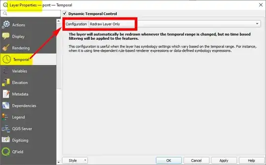

  1. In Layer Properties > Temporal tab, you can just define one single start and stop time. However, you can set the configuration to Redraw Layer Only: like this, the layer redrawn every time the temporal range changes.
