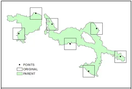

Solution to this is near identical to Creating buffers of specific size. It is about iterations... Script below assumes that you have initial squares layer (clone) and its' table has reference to limiting polygon OID:
Adjust naming of layers in your map to match ones in a script and run it from Python window.
d = arcpy.Describe("PARENT")
SR = d.spatialReference
parentShapes = {oid:shp for oid,shp in arcpy.da.SearchCursor("PARENT",["OID@","SHAPE@"])}
with arcpy.da.UpdateCursor("clone",["SHAPE@","AREA_M2","ORIG_FID"]) as cursor:
    for shp,target,parent in cursor:
        parentPgon = parentShapes[parent]
        cPoint = arcpy.PointGeometry(shp.centroid,SR)
        middle = pow(target,0.5)/2
        low = middle; high = middle*10
        while True:
            middle=0.5*(low+high)
            square = cPoint.buffer(middle).extent.polygon
            isect = square.intersect(parentPgon,4)
            if (high - low) < 0.001: break
            curArea = isect.area
            if curArea<target:low=middle
            else:high=middle
        cursor.updateRow((isect,target,parent))
Output:
