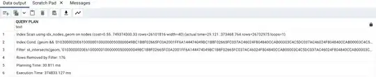

Total query runtime: 15 min 28 secs. 26732975 rows affected. Analyze for this query is: enter image description here

Total query runtime: 5 min 6 secs. 25624080 rows affected. Analyze for this query is: enter image description here

Also, for performance, a lot of things can impact. For example because parallel index scan is only for btree indexes, GIST index are scanned in mono thread. Compared to a parallel sequential scan, it can be less efficient if your result is a significant portion of your total table. In this case, it's possible that index scan is only efficient when you're looking for a small portion of your table.
