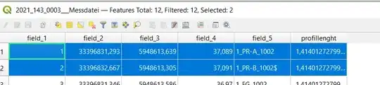

Yet I keep getting back the null values, although the same method (with pointing out the layer names instead of algorithm's outputs) used in field calculator outside of modeler gives back right output. fieldcalc output in modeler Expression used in fieldcalc outside modeler:
     distance(
 geometry(get_feature_by_id( '2021_143_0003___Messdatei_155ee37b_b40d_40d4_beb6_fe01679f19f4', '1')),
 geometry(get_feature_by_id( '2021_143_0003___Messdatei_155ee37b_b40d_40d4_beb6_fe01679f19f4', '2'))
Output: Fieldcalc output outside the model
