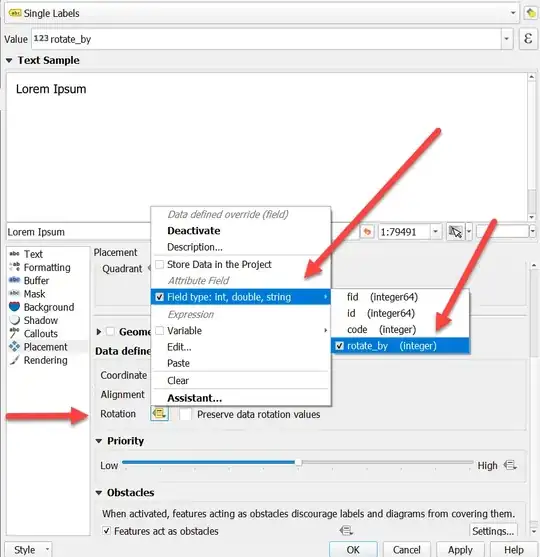

You can control the label rotation by using the data driven option for label placement. This might work for you: enter image description here In this example, there is a field called rotate_by and is set to either 90,-90 or 180. The result of this is shown here (with field rotate_by used as the label field: enter image description here
If you want the rotation to be a fixed value, you don't need a dedicated field - you just need that value e.g. 90. Click on Edit on the menu and type in the value.
If you need to rotate symbols - similar approach -> data driven rotation: enter image description here

  • It doesn't help frankly. I need something, which would allow me to rotate the point object with labels as well. This time I can't use the rotate value, as in the Value section I have already defined something. – Geographos Mar 30 '22 at 15:26
    answer edited! Not sure if it will help. – Aquamarine Mar 30 '22 at 17:11
  • I think, that eventually, it will. I realized, that fiddling with the attribute table is essential here. Thanks for your help. – Geographos Mar 31 '22 at 08:44
