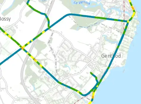

I have a feature class layer where linear features will often be digitised close to each other. These lines are all features in the same layer.
Example when zoomed in:
Problem when zooming out to export wider map:
When I zoom out, the 3 line symbols overlap each other.I want the lines to retain a decent thickness but not battle each other for space. I want them to automatically detect they are close to each other and line up side by side, or spaced out a bit for clarity. Like:
