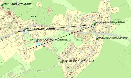

I would like to connect my points with one point at the different layer, like you see below:
but the simple option like Points to path doesn't work here, because it applies to one layer.

I need to link all the selected points with one green point, which is already under a different layer, and repeat this step for other green points, where other points will be allocated (like you can see in the data attribute table above).
Is there any way to make the lines between points, where some points must be allocated to the other point belonging to the different layer?

    Why don't you place all your points in one third layer and add a string attribute to store the layer it comes from? – Pepe N O Feb 18 '22 at 17:35
  • Are the lines just for visual purpose or do you want to create a new line layer? – BERA Feb 18 '22 at 18:06
  • @BERA yes, lines show the correlation between points I want. As you can see in the attached attribute table - to the point ended 1 I need 4 points. – Geographos Feb 18 '22 at 18:49
    Have you tried using the processing algorithm Join by lines (hub lines)? from my quick test it seems to be perfect for your case – pigreco Feb 18 '22 at 20:06

OK, the basic solution is here:
Joining many points with lines?
but the primary reason, why I got nothing in the attribute date earlier was the wrong combination between the unique columns in both data attribute tables. Since the link above states, that it's enough when we use just unique columns (with unique data) between both data attribute tables I would say, that it's not always true. It depends on what our string is and does the column content matches itself between these 2 unique columns considered. If, for instance, we will have some discrepancies there, then the tool probably will throw just empty records. Thus much better is to use just ID as the unique column in both layers, it's the safest approach, which guarantees the result as below:
