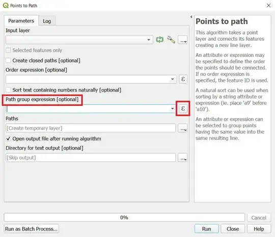

(QGIS 3.22.3) In the Points to path tool, you can use an expression in the Path group expression option to group your data.
Click the button on the right of the field to open the expression editor.
Enter this expression. "date" and "indiv" are field names from your point layer, || is the concatenate operator. Be careful with double " and single ' quotes. Double quotes are for field names, single quotes are for strings.
"date" || '_' || "indiv"
It concatenates the date, an underscore, and the individual's ID. The result of the expression would look something like 2022-02-21_1 (and so on for each combination of date and indiv).
You won't see this calculated anywhere (except in the preview in the lower left of the expression editor). But the Paths to points tool will use it to group your points.
The paths are then generated per group.

For a more explicit version of the same concept (which will work on QGIS versions before the Path group expression option was added), you can use Field Calculator (with the same expression "date" || '_' || "indiv") to generate the groups in a new Text field (called group).
And then select this field in the Group field of the Points to path tool

  • I'm sorry Matt, I am afraid I do not understand this completely (I am a real QGIS newbie, I'm sorry). Where can I find the "path group expression option" in the points to path function? And should I then add this expression for every date and every individual that needs to be grouped? – Roos Feb 23 '22 at 12:00
  • No problem, we were all newbies once. I have updated my answer with some clarifications. You only need to make the expression one time. It will be calculated on every row of your attribute table, using the values it finds in the two fields. – Matt Feb 23 '22 at 13:27
  • Hello Matt! I do not see that expression , this is what I see in the points to path tool: link – Roos Feb 24 '22 at 11:34
  • It must be a feature added in a more recent version of QGIS. You can use the second part of my answer in that case, and make the groups with the field calculator (after the title "Variation"). – Matt Feb 24 '22 at 11:35
