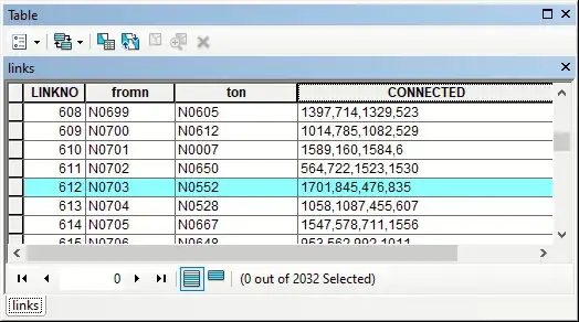

Derive lines end points, delete spatially identical, name points and transfer their attributes to lines table:
Export lines table to 2 identical stand-alone table in GDB, e.g. ABC and CBA and Make Query Table No1:
Repeat to create Query Table No2 and 3, using:
ABC.ton = BCA.fromn
and
ABC.ton = BCA.ton
You'll need to export all query tables and concatenate them. Table below shows all lines connected to line 612, compare it with 1st picture:
This hectic workflow can be replaced by tiny field calculator expression:
import collections
from collections import defaultdict
dF,dT=defaultdict(list),defaultdict(list)
tbl=arcpy.da.TableToNumPyArray("LINKS",("LINKNO" , "fromn" , "ton"))
for i,f,t in tbl:
 dF[f]+=[str(i)]; dF[t]+=[str(i)]
 dT[t]+=[str(i)]; dT[f]+=[str(i)]
def getConnected(i,f,t): bigList = set(dF[f]+dT[t]) bigList.remove(str(i)) return ','.join(list(bigList)) #----- getConnected( !LINKNO!, !fromn! , !ton! )
