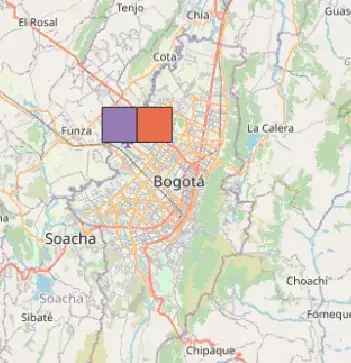

QGIS v3 only shows test1_b and test1_c:
Notes
  • Geohashes d2g6b, d2g6c and d2g6f are horizontal neighbors. As showed before, the ISEA projection use ellps=sphere, and as showed by illustration (d2g6c box), QGIS can plot ellps=sphere... I supposed that QGIS can plot d2g6c also, using similar infrastructure.
