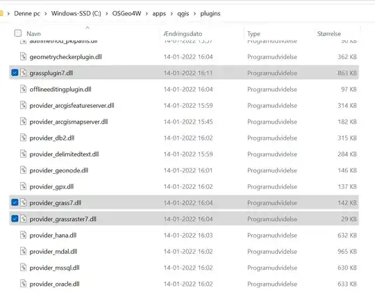

2022-02-04T15:21:36     WARNING    Failed to load C:/OSGeo4W/apps/qgis/plugins/grassplugin7.dll (Reason: Cannot load library C:\OSGeo4W\apps\qgis\plugins\grassplugin7.dll: The module was not found.)
2022-02-04T15:21:36     WARNING    Failed to load C:/OSGeo4W/apps/qgis/plugins/provider_grass7.dll (Reason: Cannot load library C:\OSGeo4W\apps\qgis\plugins\provider_grass7.dll: The module was not found.)
2022-02-04T15:21:36     WARNING    Failed to load C:/OSGeo4W/apps/qgis/plugins/provider_grassraster7.dll (Reason: Cannot load library C:\OSGeo4W\apps\qgis\plugins\provider_grassraster7.dll: The module was not found.)
But it seems that the files are in the library at the exact path:
For me it seems that my paths are wrong. Therefore I tried to make the paths more simple, but it didn't work, so now I am back to default settings.

  • Hey, did you install the "qgis-ltr-glass-plugin" when you installed it through the OSGeo4W installer? – HeikkiVesanto Feb 08 '22 at 12:18
  • Hey Heikki, I tried to install everything I could. That exact file does not appear in my files, but i have two files called "plugin_grass7.dll" and "plugin_grass7.pdb". Does that point on a problem in the installation? – MadMagister Feb 08 '22 at 13:26
  • So when you install through the OSGeo4W installer in the Advanced installation, "qgis-ltr-glass-plugin" is one of the libraries that you can install. – HeikkiVesanto Feb 08 '22 at 14:18
  • I went through the installation again, reinstalled "qgis-ltr-grass-plugin". Now it appears in my files, but when I try to use the v.net.alloc tool from the processing toolbox it gives med the same error: LOCATION not available (The first error in my question). – MadMagister Feb 10 '22 at 07:28
  • However, now it seems in my "Log messages" that the grass plugin loads correctly. – MadMagister Feb 10 '22 at 07:39
  • Can you try a different user without the Ø? – HeikkiVesanto Feb 10 '22 at 09:31
  • Yes, should I just rename the folder? The reason I have not done so yet is that I am nervous about whether I am destroying some other paths or fundamental settings. Is there a reason to be worried? – MadMagister Feb 10 '22 at 09:39
  • It's your User folder, so you should not rename it. I would try creating a new user account on the machine without the character to test if that is the issue. – HeikkiVesanto Feb 10 '22 at 09:51
  • That was exactly the supervising i needed. It works with the new user, thank you very much! – MadMagister Feb 10 '22 at 11:02
  • Perfect. I have added my comments as an answer in case someone else comes across the same issue. Might be worth logging as a bug, it's a bit unfair to the Danish, but I'm not sure if it would be one for QGIS or for GRASS. Probably GRASS based on the error message. – HeikkiVesanto Feb 10 '22 at 17:34
You should try installing the "qgis-ltr-glass-plugin" from the OSGeo4W installer in the Advanced installation section.
If that does not resolve the issue you can try creating a new user on your computer without the non-English character "Ø". That will narrow down the issue.
