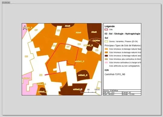

Exemple 1 of atlas page
Exemple 2 of atlas page

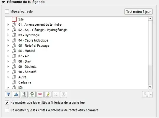

Legend text of all layers

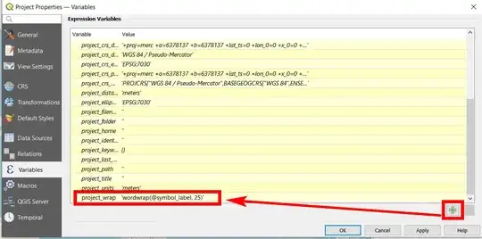

To add to @HeikkiVesanto's solution: Go to Project / Properties / Variables, create a new variable called project_wrap and insert the expression there.
The advantage is the possibility to automatically update the length of the lines of all layers at once in the legend. Use the variable in the print composer (instead of the whole expression): paste eval(@project_wrap). If you then change the variable definition (change no. of characters), the line-length automatically changes at once for all lines defined with this variable. Not need to manually tweek each line separately.
Updating of the legend takes a while. Simply open the expression button and close immediately, then the legends updates.

  • For me, it seems to work with your project, see: https://i.stack.imgur.com/42SrL.png - But only in this layout; the other two have no legend and I get an error saying No matching atlas features found!. I'm not sure but I guess the others are raster layers. With rasters, this solution does not seem to work – Babel Sep 16 '21 at 12:44
  • Indeed it works with this layout. The other two are the ones where i did an atlas focused on only 1 polygon, and several layers per pages. Maybe for those ones, there is too much data to handle idk. Your error tho should comes from the path of the layer "Site". If you make a new shp and then change the path of the layer "Site" it should works. – Florian Marlière Sep 16 '21 at 13:15
