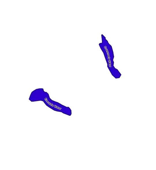

There is still some work to do with the densification and simplification steps and some speed up but I'm quite happy with the results so far:
