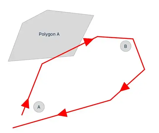

I want to be able to find Points near (with a given threshold) a given Line-Geometry and Polygons that it crosses. I already have that part of the problem solved, but now I'd like to order the results. Fist match first, last match last.
Here's a sample: enter image description here
My result should be something like:
1 | point A
2 | polygon A
3 | point B
4 | point A
I've tried ST_Line_Locate_Point which seems to do basically that, but this will only give me the closest match, right?
So my problem would be the following. My input line crosses a certain point twice. One time a bit closer on the way back e.g. a bit further away. Is there anything build into PostGIS to help me with that? Or will I have to do the analysis of something like that on my own?
How would you approach this problem?

The repeated passing of the same point is tricky, and you won't get any direct help from PostGIS.
However, you can
  • create a sequenced set of minimal components (two-vertice segments) from your LineStrings
    SELECT id,
           seq,
           geom
    FROM   (
        SELECT ln.id,
               dmp.path[1] AS seq,
               ST_MakeLine(
                 dmp.geom,
                 LEAD(dmp.geom) OVER(PARTITION BY ln.id ORDER BY dmp.path)
               ) AS geom
        FROM   <line_table> AS ln,
               LATERAL ST_DumpPoints(ln.geom) AS dmp
    ) q
    WHERE  geom IS NOT NULL
  • find all geometries in range and ORDER BY the sequenced segments and the fraction of line length at which those geometries (for Points) or derived Point geometries (for Polygons) project onto the line segment:
    WITH
      segs AS [MATERIALIZED] (
        <above_query>
    SELECT other.id
    FROM   segs
    JOIN   <other_geometries_table> AS other
      ON   ST_DWithin(segs.geom, other.geom, <threshold>)
    ORDER BY
           segs.id, segs.seq, ST_LineLocatePoint(segs.geom, other.geom)
The above is working on Points only. You will have to derive a Point geometry from any crossed Polygon somehow; some options are to use
  • the ST_Centroid of the Polygon, after determining if it is crossed
  • the ST_Centroid of the ST_Intersection between Polygon and LineString
Using ST_Centroid has the advantage that you can pass in Points, which may make streamlining the query on mixed geometry types easier, if you are indeed using a mixed geometry types table as other.
If not, you can UNION ALL queries on both tables; select all fields (including the ST_LineLocatePoint fraction), and ORDER BY in an outer query:
WITH
    <above_query>
SELECT ROW_NUMBER() OVER() AS seq,
       q.id
FROM   (
  SELECT point.id,
         segs.id AS _id,
         segs.seq AS _seq,
         ST_LineLocatePoint(segs.geom, point.geom) AS _frac
  FROM   segs
  JOIN   <point_table> AS point
    ON   ST_DWithin(segs.geom, point.geom, <threshold>)
  UNION ALL
  SELECT polygon.id,
         segs.id AS _id,
         segs.seq AS _seq,
         ST_LineLocatePoint(segs.geom, ST_Centroid(ST_Intersection(segs.geom, polygon.geom))) AS _frac
  FROM   segs
  JOIN   <polygon_table> AS polygon
    ON   ST_Crosses(segs.geom, polygon.geom)
) q
ORDER BY
       _id, _seq, _frac
Note:
This will double-count point B in your example! And that may or may not be intended: does the line pass point B twice? This is a general question of context and algorithm theory that you will encounter with this task, no matter the methodology. E.g. to exclude point B from getting counted twice, you'd need to add a rule to remove duplicates in adjacent segments.

    Thank you so much for your super detailed answer! Really appreciate it! As I am pretty much a Postgres and Postgis noobie...
    So basically you go and split up my input line as multiple lines each containing two coordinates? Then you go and match those multiple line-segments?!? Order them and therefore I am already able to find multiple hits.
    I think I need to let this sink a bit and also make some research on what MATERIALIZED, LATERAL, PARTITION and so on are doing, but this is an excellent starting point!
    Thank you very much!
    – Georg Mar 17 '21 at 14:58
  • That's about the gist of it; the LineString gets segmentized into its components (an individual LineString for each consecutive pair of vertices of the original), and each of those will get analyzed for geometries in range, and their position along the segment; the rest is just ordering. You will see that the results may differ from what you expect, e.g. does the line pass point B twice? You (human) may say no, but here (algorithm), when in range of multiple segments, then yes! In fact, this is a general semantical problem you encounter with this task, no matter the methodology. – geozelot Mar 18 '21 at 10:31
