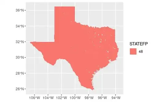

tx_tracts_sans_water <- get_tracts("TX",year=2018) tx_tracts_sans_water %>% ggplot(aes(fill = STATEFP)) + geom_sf(col=NA)
texas cutout example
This takes a long time but it does "work." I did explore parallelizing this operation but did not have any luck with adapting the existing solutions (parallel, multidplyr) to spatial dataframes. With any luck, someone with expertise in one of those libraries will provide a better solution, or a data.table expert will show us how to do this in one line of code.
