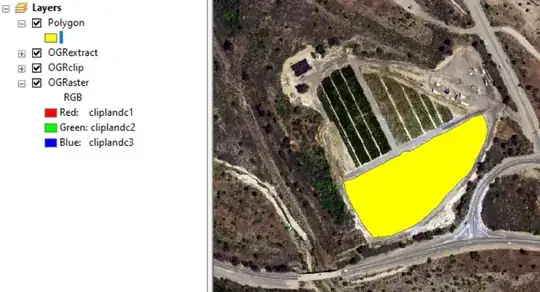

I am trying to exclude multiple lakes and reservoirs from a Supervised landscape classification but at the moment I have not found a way to do this. So far I have used the following workflows:
1.Draw a polygon -> Clip -> Extract by mask) generates the opposite result.
2.Draw a polygon -> "Raster to Polygon" -> Reclassify -> Set Null, but the reclassification removes RGB symbology
Details:
I am using an Multiband High resolution Raster image I am working on the latest version of ARCmap for Desktop I would like to retain the RGB Composite symbology

  • Thank you for your answer, I followed the workflow but something is not working. I create a polygon and use that and the original raster for the "polygon-to-raster" step, but the low/high ramp values become zero. Additionally, when I reclassify the data, "polygon" as a valid entry. Any thoughts? - Thank you – Max Amaya Nov 16 '20 at 00:43
  • The polygon to raster conversion will create a raster but it's value will come from the field you used, typically the FID or OBJECTID. So if the polygon the FID was zero then the cell values are zero, if it was 123 then the cells are 123, you then reclassify those cells to 1 and what are the surrounding nodata to 0. Also make sure you ensure extent is set, I think I have left that off in the original answer so have updated my answer. – Hornbydd Nov 16 '20 at 12:36
  • Looks like that did the trick, but now I have lost the RGB composite symbology option which is important for the supervised landscape analysis that I am trying to do. Is there a way for the new rater to be displayed as RBG composite? – Max Amaya Nov 17 '20 at 09:28
  • You never originally said it was an RGB raster, that's why you should always include images in your question and give as much detail about your datasets. This approach works for 1 band rasters. – Hornbydd Nov 17 '20 at 12:13
  • I updated the question with an image that showed the the raster with it's multiple bands after our first exchange but I did forget to mention it my reply. I apologize for the inconvenience and thank you for your time, I learned much from following your workflow. If you do have some suggestions on how to do this with multiband image I would appreciate it. – Max Amaya Nov 17 '20 at 17:08
  • You could try adding the individual bands, process each band independently then use the composite bands tool to merge them back into a single RGB raster? Don't know if that will work. – Hornbydd Nov 17 '20 at 21:18
    I found an alternative that yields the desired results, the workflow is as follows: 1st. Using the Draw Menu create two polygons (one of the total extent of the raster), the second for the area that needs to be excluded. 2nd. Use "Graphics Operations" from the drawing menu and select "Remove Overlap". 3rd. Convert them to features (.shp) using the "convert graphics to features" and lastly 4th. "extract by mask" – Max Amaya Nov 17 '20 at 21:31
