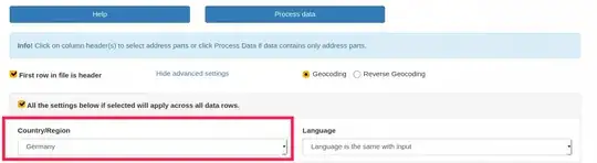

Note: If your original file had contained only postal codes without an identified country/region, you could have clicked on “Show Advance Settings” and select the desired country, assuming all data was from the same country.
select country before geocoding
