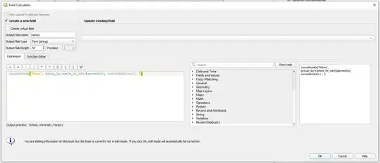

Let's assume there is one point layer "points" (3 features at the same location) with its corresponding attribute table, see image below.
input
Step 1. In the Field Calculator create a new attribute, e.g. "Names" and fill it using the following expression
concatenate("Name", group_by:=geom_to_wkt($geometry), concatenator:=', ')
step_1
Step 2. Apply "Delete duplicate geometries".
step_2
Step 3. Delete irrelevant fields or add new fields.
step_3
