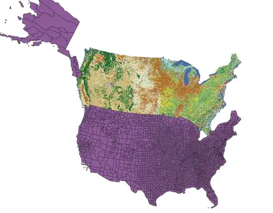

Problem Summary: Default QGIS CRS is 4326. I load in the NLCD data, set the NLCD layer CRS to EPSG:102003 (Albers). I then set the project CRS to the same. Then loading in the Shapefiles for the US County data, I get the image below. Showing that the layers are offset.
NLCD Data & Shapefiles Layer
