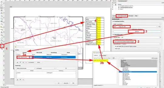

Just an idea for a partial workaround so that you don't have to do everything manually: insert on your atlas sheet an attribute table and list there the names of the towns (no. 1 in the screenshot below).In the feature properties of the table select the object filtering tab and activate the checkbox "Show only features visible on the map" (2). Add an additional attribute to the table in the print composer (3), this time a custon defined, based on the variable @atlas_featernumber - manually (3a) or in the expression editor (3b) - this should correspond to the page-no. If you navigate from page to page in the atlas, the variable will be printed as the no. of the current feature.
So if your first page in the print layout contains the map that generates the atlas, the variable is identical with the page-no. (otherwise add the amount of additional pages to the expression generating your manually created attribute in the edior, 3b). By this, you get for each atlas page a list of the towns showed on this page and in a second row the page-no (4). Copy all the lists and paste them together and you have your index.
To sort the list alphabetically, add a definition in the attributes dialogue window (underneath of 3a).
There might be a better solution based on the expression intersects( $geometry , @atlas_geometry ) - thus creating a statement based on the question if the geometry of a town lies within (intersects) with the grid of your polyon-layer that generates the atlas-pages - however right now I don't know to implement the page-no. with this on a separate (empty) page to create a completely automatic index.

  • Thanks. I'll look into that as soon as I get a chance. Even if it is a bit of work that's fine. I just didn't want to try to manually do a list with potentially several hundred features. – Troy Buerge May 20 '20 at 19:46
  • I tried that out. It did work kind of. I still can't copy from an attribute table to something else, so at this point it still leaves me manually entering everything – Troy Buerge May 22 '20 at 00:09
  • I ended up exporting my atlas with only the attribute table showing, and then i could copy it off each page from the pdf. – Troy Buerge May 22 '20 at 02:04
  • Nice to hear that you managed to achieve what you wanted. However, I guess there is a better solution to this problem and that's a more general question that will appear again. That's why I posted the question in a modified form again, see: https://gis.stackexchange.com/questions/362615/qgis-expression-to-access-page-number-of-atlas-for-certain-features – Babel May 22 '20 at 11:19
  • There's already a solution that should allow you to accomplish your towns index completely automatically - it least here with my project it worked perfectly. So please vote for she_weeds if you find her (his?) solution helpful: https://gis.stackexchange.com/questions/362615/qgis-expression-to-access-page-number-of-atlas-for-certain-features/362622#362622 – Babel May 22 '20 at 15:52
