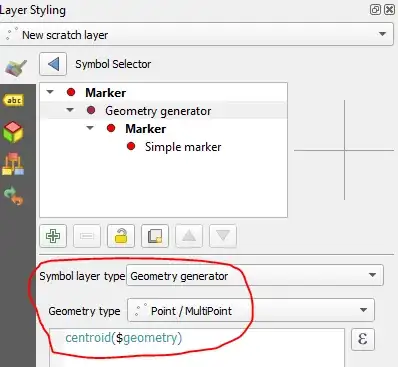

  • Use a Geometry Generator style. In the Layer Styling panel, where it says "Symbol" click the "change" button. Change the symbol layer type to "geometry generator", use the formula centroid($geometry) and change the geometry type to point. Or, if the centroids are not all inside their respective polygon, use point_on_surface( $geometry).

  • i'm tryinf to do that but I have polygons layer and not dot layer, is there anyway to do the same thing without creating points from my polygons? – ReutKeller Mar 24 '20 at 17:15
  • You can add a new layer (using a virtual layer) extracting the centroid of your polygon layer ... – Snaileater Mar 24 '20 at 17:46
  • @Reut I added a few methods for converting to points at the end of my answer. I would probably go with the geometry generator method. – csk Mar 24 '20 at 19:48
