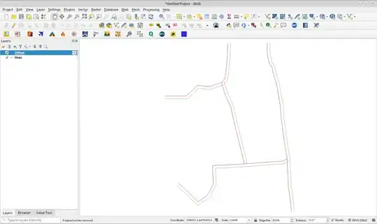

By using 'qgis:offsetline' of Processing Tool Box, you can do that with a few lines of code; as in following script.
import processing
layer = iface.activeLayer()
parameters = { 'DISTANCE' : 5, #offset of 5 meters
               'INPUT' : layer,
               'JOIN_STYLE' : 1,
               'MITER_LIMIT' : 1,
               'OUTPUT' : 'TEMPORARY_OUTPUT',
               'SEGMENTS' : 8 }
processing.runAndLoadResults('qgis:offsetline',
               parameters)
I ran above script with line layer (in red) of following image; where offset line was drawn in blue.
