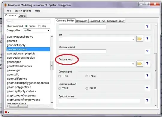

Personally I do not like the random point algorithm in ArcGIS. Alternatively, use Geospatial Modelling Environment's (GME) genrandompnts function. You will be able to identify specific polygons where random points will be excluded (see highlighted area in attached .jpg). Best of all this software is free.
GME provides you with a suite of analysis and modelling tools, ranging from small 'building blocks' that you can use to construct a sophisticated work-flow, to completely self-contained analysis programs. It also uses the extraordinarily powerful open source software R as the statistical engine to drive some of the analysis tools. One of the many strengths of R is that it is open source, completely transparent and well documented: important characteristics for any scientific analytical software.

    Can you give further info on why you don't like the default random points algorithm, and why GME's is more optimal? – Stephen Lead Sep 19 '12 at 23:17
  • @Aaron Nice one! Haven't tried this since it was Hawth's Modelling Tools - I'll have to download it and give it a crack! – om_henners Sep 19 '12 at 23:20
    @Stephen Within the last month, I was generating random points across four classes. I encountered several issues: 1) ArcGIS produced several points outside of my input polygons 2) Arc had a difficult time dealing with areas too small for my input parameters (e.g.. minimum allowed distance = 50m & points = 50), whereas GME handled these issues by producing random points up until rules were violated then displaying a warning message 3) Arc's RPG is slower than GME's probably due to R's use of local memory. – Aaron Sep 19 '12 at 23:54
  • Nice one! Does it have a python bounding so that I can do some batch processing @Aaron ? – Seen Sep 20 '12 at 00:56
    @Seen check out automation and batch processing section (p10) in the support document: http://www.spatialecology.com/gme/images/SpatialEcologyGME.pdf – Aaron Sep 20 '12 at 14:07
