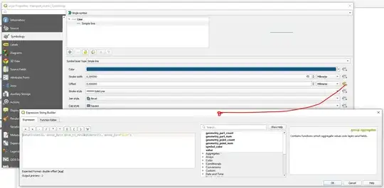

I truly believe that I have got your question correctly. Thus, you want an offset where transport lines share same geometry otherwise they have to remain at the same place.
Let's assume there is a point layer "transport_routes" with its corresponding attribute table accordingly, see image below.
input
For Labelling I used this expression:
array_to_string(array_agg("Line", group_by:=geom_to_wkt($geometry)))
IMHO here is a workflow.
Step 1. Perform what @Kazuhito suggested in his answer, i.e. break the polylines into segments. Alternatively check this article Splitting all lines in layer at vertices using QGIS?.
Step 2. Proceed with RMC > Symbology > Offset > Edit... and using an expression below, see image below.
window_offset
The expression:
range(count(1, group_by:=geom_to_wkt($geometry)), group_by:="Line")
The result will look like
result
