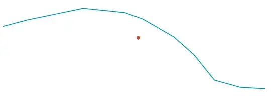

For selecting the line's middle point it is not enough just using ST_Centroid(). Because (as described in manual) it is computed as the weighted length of each line segment. Therefore, with the following query
SELECT st_centroid(geometry)
FROM "line"
the line geocentoid is the location of the arithmetic mean of weighted properties, see image below.
result_1
