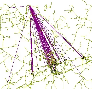

I have 61 pts and numerous rds. I would like to find the shortest distance to the nearest road using st_shortestline. I need 61 unique line segments, one for each point to its nearest road. Instead I am getting 61 line segments from each point to a particular road (not the nearest). How can I adjust my query to produce the proper results?
SELECT DISTINCT ON (p.id) p.id, p._unique, r.rd_name, ST_ShortestLine(p.geom,r.geom) into shortest_line FROM pois_sample p, allrds_sample r;
Outcome:
Desired Outcome:

  • yes and no; ST_ShortesLine does give you what it says, the issue is the cross join of your tables; for each point, this will create the shorest line from it to every road! if you want the shortest line to the one closest road for each point, a LATERAL JOIN is needed. to speed things up, PostGIS offers the KNN operator <-> (see links). if you then also only want the (numerical) distance, use e.g. ST_Distance (or replace it with ST_ShortestLine otherwise). if you have trouble translating it to your usecase, I write up an answer. this is, however, a close duplicate to the links. – geozelot Aug 14 '19 at 21:46
